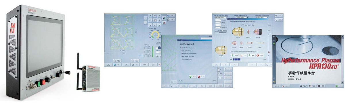

Phoenix® software is the core operational interface and is common across the entire Hypertherm family of CNC systems. The software is designed specifically for the X-Y and bevel cutting market.
Key benefits include:
  • Integrated communications to plasma and torch height control systems for automated and expert control of the cutting process
  • Built-in cut charts for automatically setting process parameters for mild steel, stainless, and aluminum to enable consistently optimized cutting performance
  • Wizards and diagnostic support tools that enable easy setup, use and rapid troubleshooting
  • The Remote Help utility that enables expert cutting system diagnostics over the internet to reduce downtime
  • Built-in help and cutting optimization tips for improving table performance and process outcomes at the touch of a button.

CutPro Wizard
The patent-pending CutPro wizard is an intuitive step-by-step process that guides the operator through the most frequently required job setup steps. In field trials, new operators began cutting high-quality parts in less than 5 minutes without training, drastically reducing the “hire to cut” time. This means that multiple operators across multiple shifts can quickly produce consistent results, making it so you have your best operator on every shift.

Real-time Monitoring
Real-time monitoring screens
Watch Windows enable on-screen, real-time monitoring of key process and performance information while cutting.
Examples of variables that can be monitored include:
  • Estimated processing time for the part or nest
  • Plasma process information
  • Table motion commands and feedback for quality of motion detail
  • Status of system inputs and outputs
  • Cutting parameters such as speed, arc voltage, kerf width, gas flows, etc.
These windows are always visible and accessible during the cutting operation providing the operator the ability to monitor the table performance at any time.
