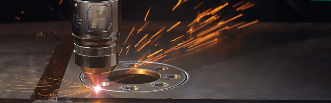

Since its initial release, True Hole® technology has become a mainstay for those who demand high-quality bolt ready holes. Historically, machine operators had difficulty achieving good hole quality directly off the plasma cutting table, with drilling often required as a secondary process. True Hole technology—a patented process for mild steel that virtually eliminates hole taper and improves roundness—produces significantly better hole quality than what was previously possible using plasma.

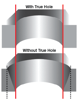

True Hole eliminates taper and improves roundness
Image showing cylinder with and without True Hole

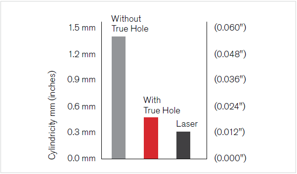

Hole cylindricity
Bar Graph showing Hole Cylindricity
Example based on 0.394" holes, 3/8" mild steel plate, 130 A process

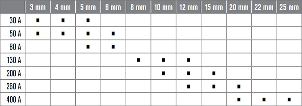

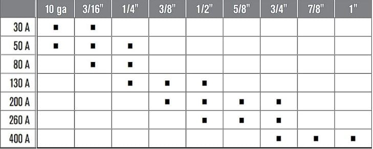

XPR - True Hole processes by thickness
Thickness table XPR True Hole
Thickness Chart True Hole Gage image

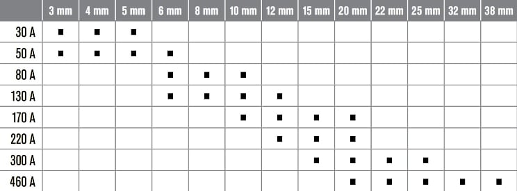

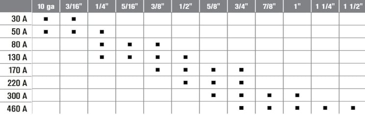

HPR - True Hole processes by thickness
Chart-HPR process thickness
Chart-HPR process thickness imperial
