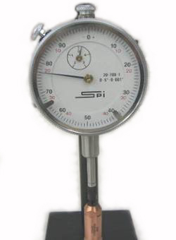

Not only is catastrophic failure ugly, it is expensive! Instead of simply replacing an electrode, this entire consumable set (and maybe even the torch) will have to be scrapped. After a while, you can pretty much tell how worn an electrode is just by looking at it. But, if you want a more precise way to measure wear, Hypertherm does sell a dial indicator to accurately measure wear. The photo below shows the indicator with the partially used electrode on it.
As a reminder, the 0.040 recommended pit depth is for our standard all-copper electrodes. If you are using a silver electrode you can actually go to 0.080 of an inch, which is twice the pit depth of a standard electrode.
