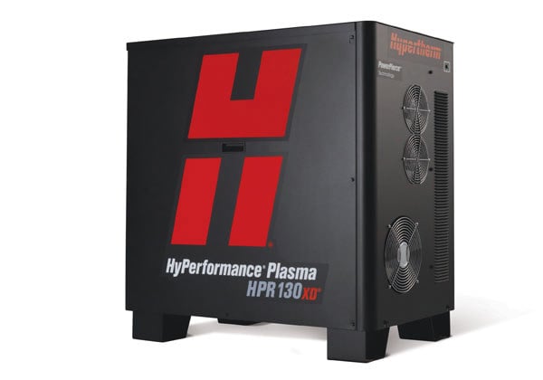

HyPerformance HPR130XD
The HyPerformance® HPR130XD, 130 amp plasma power supply was last manufactured in October, 2019 and is no longer available for sale from Hypertherm. We continue to make original replacement torches, consumables and repair parts.
Hypertherm Technical Service department continues to support this model and technical documentation for self-service is available in our Documents Library.
