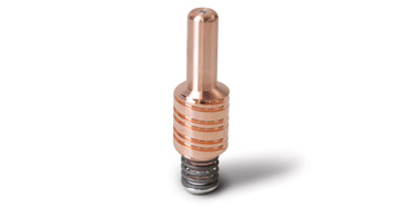

SilverPlus electrodes
SilverPlus® electrodes incorporate a hafnium/silver interface at the point of electrical transfer. The hafnium/silver extracts more heat and has a stronger bond than hafnium/copper.
The result: dramatically longer electrode and nozzle life – increasing productivity and lowering operating costs by reducing the number of consumable sets used and changeouts.

Friction-welded silver/copper joint
Unlike conventional copper/silver electrodes, SilverPlus electrodes feature a robust solid-state copper/silver weld joint. This bond is near forge quality, ensuring the best possible electrical and thermal conductivity. This not only ensures the consistency of every electrode; it maximizes service life.
Enhanced reliability
Because the silver and copper are welded prior to electrode machining, the hafnium is guaranteed to be perfectly centered in the electrode, enhancing both reliability and cutting performance.
Twice the life of all-copper electrodes
The unique design of SilverPlus electrodes minimizes debris build up on the inside wall of the nozzle, reducing damage to the nozzle orifice. As a result, SilverPlus technology doubles the life of both the electrode and the nozzle.
