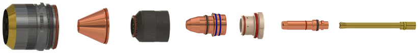

Sarf malzemeleri
Siyah sac
| Amperaj | İşlem | Muhafaza kapak |
Muhafaza | Nozul muhafaza kapağı |
Nozul | Girdaplı halka | Elektrot | Su tüpü |
| 50 A | O2/Hava | 420200 | 420237 | 420365 | 420234 | 420233 | 420231 | 420368 |
| 80 A | O2/Hava | 420200 | 420246 | 420365 | 420243 | 420242 | 420240 | 420368 |
| 130 A | O2/Hava | 420200 | 420255 | 420365 | 420252 | 420242 | 420249 | 420368 |
| 170 A | O2/Hava | 420200 | 420513 | 420365 | 420261 | 420260 | 420258 | 420368 |
