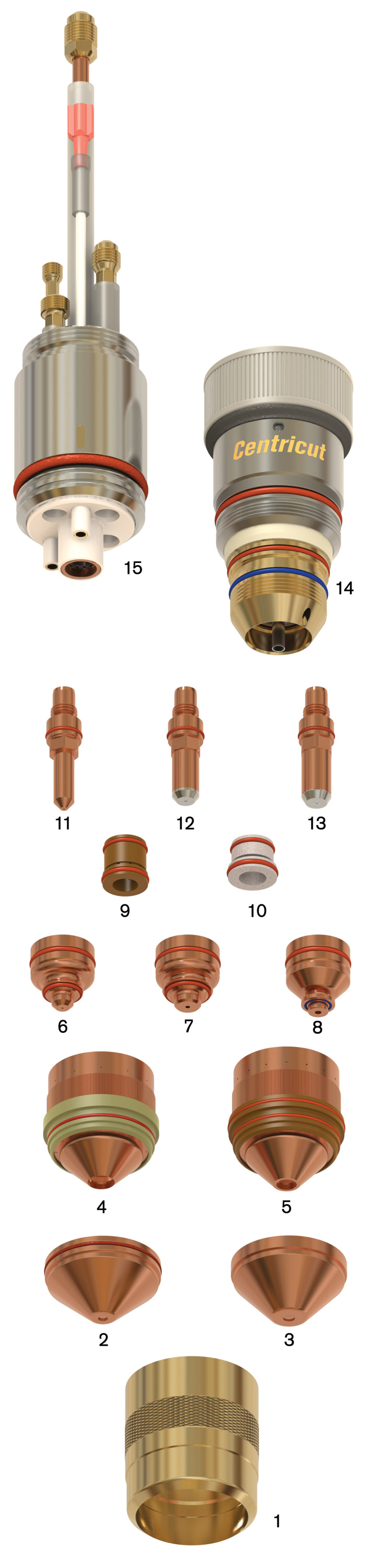

Spirit and ProLine parts list
Product line: Spirit
System: Spirit® 150a, 200a, 275a, 400a, Spirit®ll 150, 275, 400, ProLine® 2150, 2200, 2260
Consumables
1 | C107-154 | 277154, BK277154 | Outer Cap | 1 | EA |
C107-050 | 284150, BK284150 | Ret Cap Outer 400A | 1 | EA | |
2 | C107-145 | 277145, BK277145 | Shld Cap 30A MS/AL | 1 | EA |
C107-144 | BK277144, 277144 | Shld Cap 30A SS Air | 1 | EA | |
C107-115 | 277115, BK277115 | Shld Cap 50A MS | 1 | EA | |
C107-149 | 277149, BK277149 | Shld Cap 50A SS Air | 1 | EA | |
C107-150 | 277150, BK277150 | Shld Cap 70A | 1 | EA | |
C107-286 | 277286, BK277286 | Shld cap 100A Air | 1 | EA | |
I107-146 | 277146, BK277146 | Shld Rng 100A SS H17 | 1 | EA | |
C107-117 | 277117, BK277117 | Shld Cap 150A | 1 | EA | |
C107-274 | BK277274, 277274 | Shld Cap 200A | 1 | EA | |
C107-263 | 277263, BK277263 | Shld Cap 275A | 1 | EA | |
3 | C107-123 | BK284123, 284123 | Shld cap 400A MS | 1 | EA |
4 | C107-153 | 277153, BK277153 | Ret Cap 30-70A | 1 | EA |
C107-110 | 277110, BK277110 | Ret Cap Inner 30/50 A SS Air | 1 | EA | |
C107-151 | BK277151, 277151 | Ret Cap 100/150A | 1 | EA | |
C107-152 | BK277152, 277152 | Ret Cap 150A | 1 | EA | |
I107-113 | BK277113, 277113 | Ret Cap 70/100A SS H17 | 1 | EA | |
C107-266 | 277266, 200219, BK200219, BK277266 | Ret Cap 200/275A | 1 | EA | |
5 | C107-121 | BK284121, 284121 | Ret Cap Inner 400A MS | 1 | EA |
6 | C107-120 | 277120, BK277120 | Noz CoolFlow™ 30A MS/AL | 1 | EA |
C107-021 | BK277121, 277121 | Noz CoolFlow™ 30A SS Air | 1 | EA | |
C107-122 | 277122, BK277122 | Noz CoolFlow™ 50A MS/AL | 1 | EA | |
C107-023 | BK277123, 277123 | Noz CoolFlow™ 50A SS Air | 1 | EA | |
C107-125 | 277125, BK277125 | Noz CoolFlow™ 70A | 1 | EA | |
I107-124 | BK277124, 277124 | Noz 70A SS H17 | 1 | EA | |
C107-284 | 277284, BK277284 | Noz CoolFlow™ 100A Air | 1 | EA | |
I107-126 | 277126, BK277126 | Noz 100A SS H17 | 1 | EA | |
7 | C107-293 | BK277293, 277293 | Noz CoolFlow™ 150A AIR | 1 | EA |
I107-297 | BK277297, 277297 | Noz 150A SS H17 | 1 | EA | |
C107-289 | BK277289, 277289 | Noz CoolFlow™ 200A Air | 1 | EA | |
C107-269 | 277269, BK277269 | Noz CoolFlow™ 275A MS | 1 | EA | |
C107-276 | BK277276, 277276 | Noz CoolFlow™ 275A SS/AL Air | 1 | EA | |
8 | C107-025 | 284125, BK284125 | Noz CoolFlow™ 400A MS | 1 | EA |
9 | C107-140 | BK277140, 277140 | Swl Rng 30/50/70A H17 | 1 | EA |
C107-138 | 277138, BK277138 | Swl Rng 30 A SS Air | 1 | EA | |
C107-142 | 277142, BK277142 | Swl Rng 50/70A | 1 | EA | |
C107-283 | 277283, BK277283 | Swl Rng 100A Air | 1 | EA | |
I107-141 | 277141, BK277141 | Swl Rng 100A SS H17 | 1 | EA | |
10 | C107-139 | BK277139, 277139 | Swl Rng 150A | 1 | EA |
C107-143 | 277143, BK277143 | Swl Rng 200A | 1 | EA | |
C107-259 | 277259, BK277259 | Swl Rng 200A SS H17 | 1 | EA | |
C107-258 | 277258, BK277258 | Swl Rng 275A | 1 | EA | |
C107-022 | 284122, BK284122 | Swl Rng 400A | 1 | EA | |
I107-190 | 277190 | Elctd Marking | 1 | EA | |
11 | C107-130 | BK277130, 277130 | Elctd 30A MS/AL | 1 | EA |
C107-137 | 277137, BK277137 | Elctd 30/50A SS Air | 1 | EA | |
C107-131 | 277131, BK277131 | Elctd 50/70A | 1 | EA | |
I107-132 | BK277132, 277132 | Elctd Copper 70A SS H17 | 1 | EA | |
12 | C107-1082 | BK277282, 277282 | Elctd Silverline® 100A | 1 | EA |
I107-133 | 277133, BK277133 | Elctd 100A SS H17 | 1 | EA | |
C107-1092 | 277292, BK277292 | Elctd Silverline® 150A | 1 | EA | |
I107-135 | 277135, BK277135 | Elctd 150A SS H17 | 1 | EA | |
C107-1091 | BK277291, 277291 | Elctd Silverline® 200A | 1 | EA | |
C107-1070 | 277270, BK277270 | Elctd Silverline® 275A | 1 | EA | |
13 | C107-1024 | 284124, BK284124 | Elctd Silverline® 400A MS | 1 | EA |
Maintenance
C23-001 | N/A | Swl Rng removal tool | 1 | EA | |
C107-007 | 277007, BK277007 | Cooling Tube | 1 | EA | |
C107-091 | N/A | O-Rng Kit Tch Head | 1 | EA | |
C107-126 | N/A | O-Rng Kit Rear Tch Plugs | 1 | EA | |
C107-019 | N/A | O-Rng | 5 | EA | |
C107-020 | N/A | O-Rng | 5 | EA | |
15 | C107-9050 | BK279050, 279050 | Tch Base Spirit 150-275A | 1 | EA |
14 | C107-9150 | 279150, BK279150 | Tch Head Spirit 150-275A | 1 | EA |
C107-1050 | N/A | Tch Kit Spirit 150-275A | 1 | EA | |
C107-9100 | 279100, BK279100 | Tch Head Spirit 400A | 1 | EA | |
C107-1000 | N/A | Tch Kit Spirit 400a | 1 | EA | |
C107-9000 | BK279000, 279000 | Tch Base Spirit 400A | 1 | EA | |
C107-300 | N/A | Plasma Gas Tube | 1 | EA | |
I107-7000 | 277000 | Tch Body | 1 | EA | |
I107-056 | 277056, BK277056 | Noz Removal Tool | 1 | EA | |
I107-7087 | BK277087, 277087 | Elctd Tool | 1 | EA | |
028872 | N/A | TORCH COOLANT, 70/30 PG, 1-GAL | 2 | EA | |
027055 | 8-4025, 632-596 | O-Ring Lube | 1 | EA | |
I107-134 | 820134 | Tch Handle | 1 | EA |
