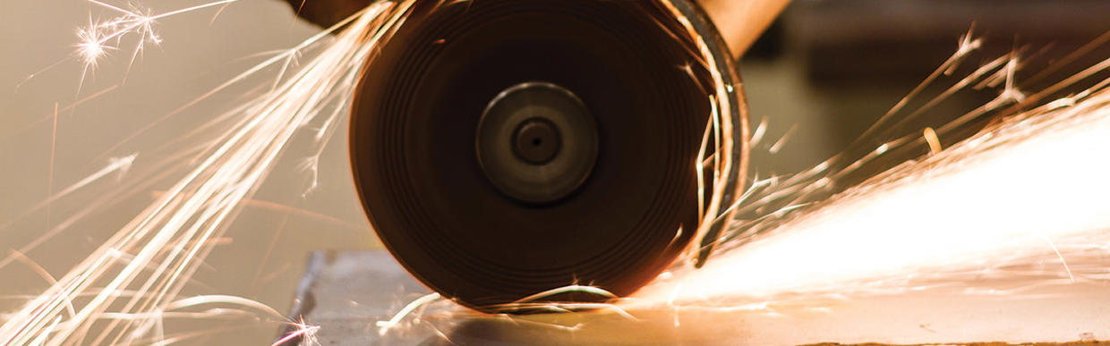

Grinders – a corded, cordless, or air-powered (often called a zipsaw) tool with a round flat blade at the end used to grind or cut material, including metal. When used for cutting, the thicker grinding blade or wheel is removed and replaced with a thinner blade called a cutoff wheel.
