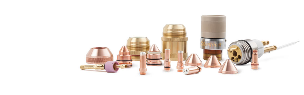

Centricut heavy-duty consumables for ESAB PT-600 and PT-19XLS
Centricut® heavy duty consumables for ESAB® torches deliver superior consumable life for all cutting processes, while providing excellent cut quality and cut speed.
  • Up to 30% longer consumable life compared to ESAB UL electrode
  • Cutting speed and cut quality equal to or better than ESAB
  • Full product line covers all cutting amperages and processes – including 200A EPP
Consumable life as measured in customer applications
Upgrade your PT-19XLS to a PT-600 to improve reliability and save money
In the standard ESAB design, the PT-19XLS has the o-ring in the electrode holder (water tube). As the o-ring is compressed repeatedly, eventually it loses its seal, and you have to replace the whole electrode holder.
The PT-600 has the o-ring on the electrode, and you get a fresh o-ring with each electrode, reducing the chances of leaking. So with a PT-600 upgrade, you will purchase fewer electrode holders and increase reliability through reduced leaking.
PT-19XLS electrode – no o-ring   PT-600 electrode – with o-ring
Cut with confidence – it’s Hypertherm
  • As the recognized global leader in plasma cutting, Hypertherm® incorporates the latest engineered and patented technologies into all consumable products.
  • Designed with critical-to-function tolerances to deliver the best quality product every time.
  • Precision manufacturing of consumables assures consistency of parts, set to set.
  • World-class plasma-process technical support.
  • Easy to use – no special system set up required.
