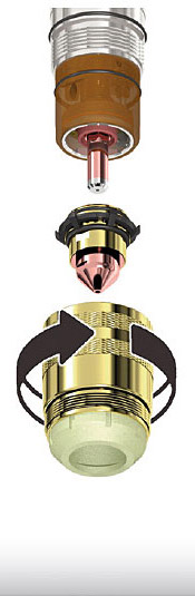

Assembly instructions
Step 1
Step 1

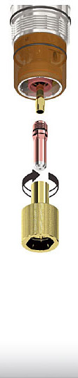

Step 2
Step 2

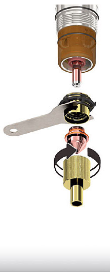

Step 3
Step 3

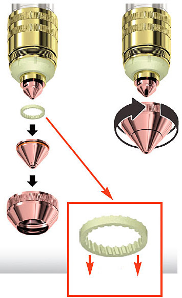

Step 4 & 5
Step 2
Smooth side down
