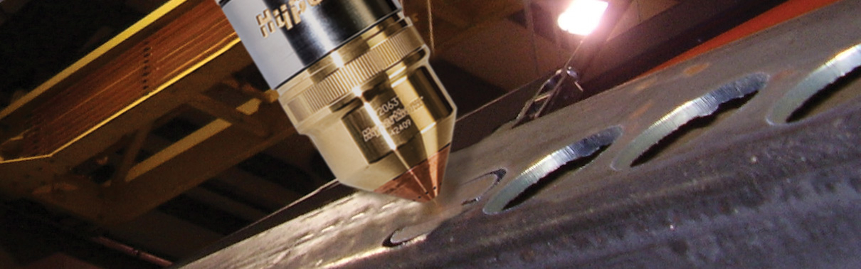

Traditionally, fabricators would cut the outside of a part using plasma, and then move that part to a second station to cut the holes. This was done because of the less-than-perfect quality of typical plasma-cut holes. They often had a fairly severe taper, in which the bottom of the hole was much smaller than the top, as well as “dings” and “divots” – essentially, notches in the inside of the hole.
Fortunately, today there are ways to nearly eliminate the taper, and the dings and divots, enabling the cutting of “bolt-ready” holes. If using plasma on an X-Y table, an operator can manually change the machine speeds and height control settings and modify the machine codes for a particular hole size, material thickness and power level. Owners of a Hypertherm high definition system, such as our HyPerformance® HPRXD, have the added benefit of True Hole® technology, which automates much of the manual work. Cutting holes by hand using a handheld plasma torch is also possible using tools like a circle cutting guide.
