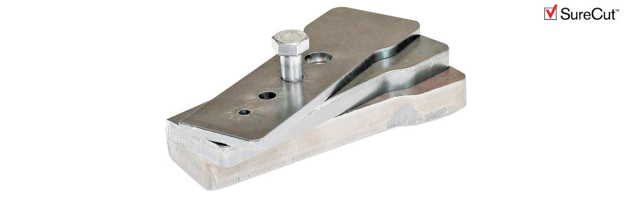

As part of Hypertherm's SureCut™ technology, our patented True Hole® technology for mild steel produces significantly better hole quality than what has been previously possible using plasma. It is exclusively available for use in conjunction with Hypertherm's HPRXD® and XPR™ auto gas plasma systems including the XPR300™ system.
True Hole is automatically applied by the nesting software or CNC software to thicknesses up to 25 mm (1”), diameter and hole coverage ranges from hole diameter to thickness ratios from 2:1 to as low as 1:1.
With True Hole technology Without True Hole technology
Hole cut using True Hole technology Hole cut without using True Hole technology

Comparison chart showing 10mm holes on mild steel with 130 A
Diagram of taper with and without True Hole
