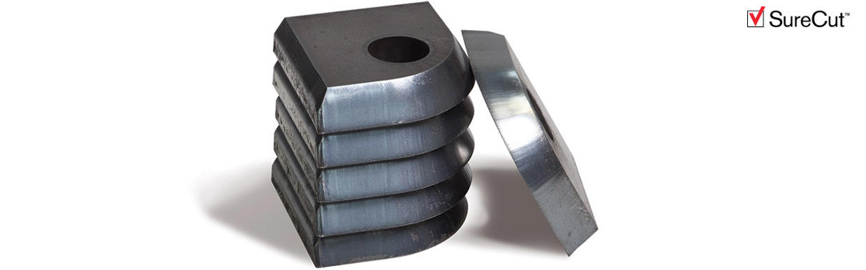

As part of Hypertherm's SureCut™ technology, True Bevel™ technology for HPRXD®  and XPR™ plasma systems is a performance application for mild steel. Factory tested and easily implemented, it takes the guesswork out of the plasma bevel-cutting process. With True Bevel, setups for new jobs are quick and results are accurate and consistent.

True Bevel technology works with all common bevel head designs.
