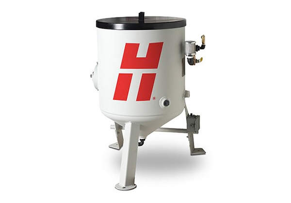

Abrasive waterjet pots
If you need additional waterjet cutting capacity, or frequently need to change abrasive sizes, an additional abrasive pot or two may be the cost-effective answer. Larger pots can also simplify storage and handling of bulk abrasive material, and offer easy access for refilling.
System information
Benefits
Add efficiency to your waterjet operation
- Ensure safer, easier handling and more convenient storage of bulk abrasives
- Use multiple pots to quickly switch between abrasive types, avoiding long downtimes
Operational features
- Low level indicator light lets operators better plan for long cuts
- Pressure regulator with water removal for incoming air
- Single valve operation to pressurize and discharge pot
- Abrasive-rated discharge valving
- Cover and screen
Capacity
- 800 lb. (363 kg) pot
Facility requirements
- 80 PSI air
- 115 VAC
Specifications
Capacity | 6 cubic feet |
Garnet capacity | 800 lbs (362.9 kg) |
Operating control | 80 psi air |
Net weight | 500 lbs (226.8 kg) |
Length | 38 in (965.2 mm) |
Width | 31 in (787.4 mm) |
Height | 43.5 in (1104.9 mm) |
Opening diameter | 24 in (609.6 mm) |
