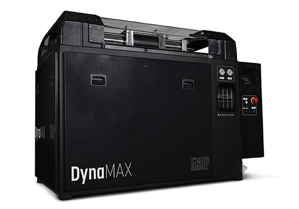

DynaMAX 5-series predictive waterjet pumps
Waterjet technology produces excellent fine-feature cut quality with low edge angularity, no heat-affected zone, a narrow kerf, and virtually dross-free cutting. It also offers the ability to process a variety of materials and a thickness range capability unmatched by other cutting technologies.
The DynaMAX™ predictive pumps (HyPrecison™ predictive) incorporate patented Seal Maintenance Technology™ and service-friendly capabilities that substantially reduce maintenance costs and disruption caused by non-planned service. With standard features such as our proven Advanced Intensifier Technology™ and closed loop proportional pressure control, these latest generation waterjet systems offer you even more consistent cut quality while ensuring improved reliability and easy, straightforward service.

DynaMAX 560P opened
