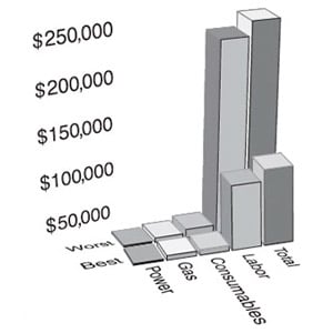

Chart illustrating plasma cost of operation best and worst case
The major power consumer in a cutting machine is the DC power supply. Most of the energy consumed by the system is put directly to work on the material in a very hot energy-dense arc. To get a rough idea of the power consumption of a plasma system multiply the amperage output by the average operating voltage. To calculate kilowatts of input consumed, multiply by a power supply efficiency factor of around 85%. For example, a 200 A plasma system has an average operating voltage of about 140V. This means the power supply puts out 28 kVA, so input consumed is calculated as 28kVA x .85 = 23.8 kW.
To arrive at daily or yearly power consumption multiply by the average up-time or arc-on time in a day. Arc-on time is the amount of time actually spent cutting during a given time interval. This can be measured by a pierce and arc-on time counter, or calculated from programming distances and speeds and daily throughput. Arc-on time will vary with material type and thickness, size of cut pieces, material handling, machine speed, torch height control speed, and many other factors.
