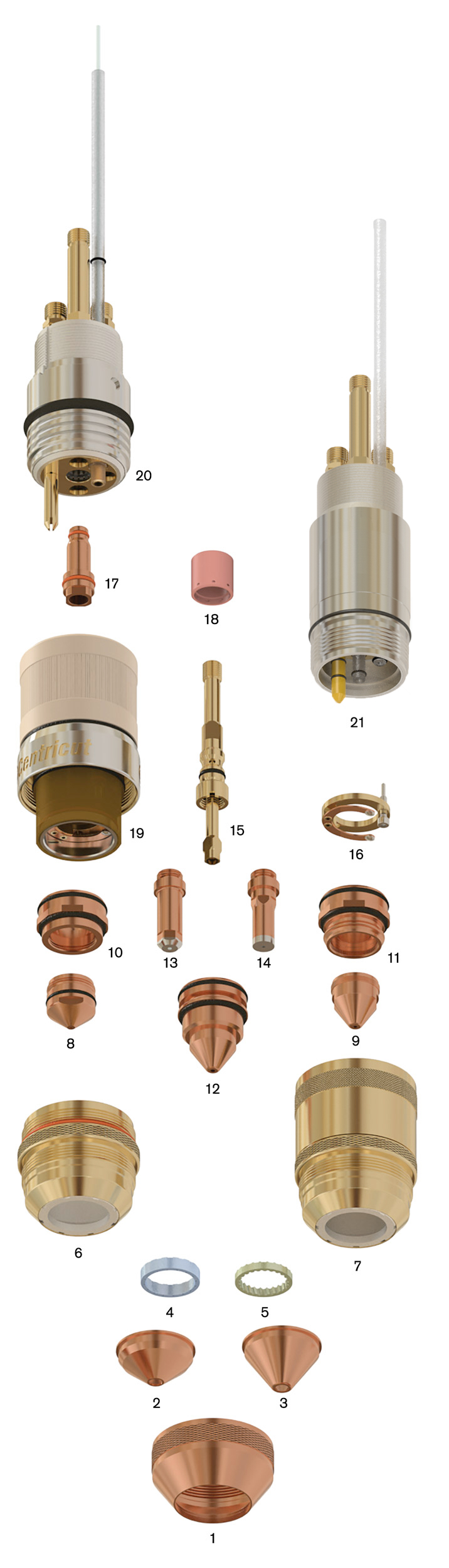

Consumables
#PartNoReferenceDescriptionPkg QtyUOM
1C47-08137081Shld Rtnr1EA
C122-3950558009395Shld Rtnr insulated Std1EA
2L47-79521795Shld 50A5EA
3C47-80221802, 0004470028Shld 100-250A1EA
C47-9450004470029, 21945Shld 325-600A1EA
4L47-79621796, 0004470031Diffuser 50A5EA
5C47-94421944, 0004470031Diffuser 100-600A1EA
C47-49622496Diffuser 100-600A Rev1EA
6C122-082N/ANoz Ret Cap Quick-change1EA
7C47-08237082Noz Ret Cap1EA
L47-43137431Noz Ret Cap Air Curtain1EA
8C47-0260004470018, 22026Noz Tip .041 50A1EA
9C47-02922029, 0004470020Noz Tip .071 100A1EA
C47-03022030, 0004470021Noz Tip .082 150A1EA
C47-0310004470022, 22031Noz Tip .091 200A1EA
C47-9220558007457, 0558005137, 22032Noz Tip 250A1EA
C47-98522034Noz Tip 360A1EA
C47-99522033Noz Tip 400A1EA
10C47-02722027, 00044700019Noz Base 50A1EA
11C47-02822028, 0004470023Noz Base 100-400A1EA
12C47-8220004470024, 0558001623, 21822Noz .099 250A1EA
C47-8850004485844, 0558001885, 35885Noz .120 360A1EA
C47-19522195, 0004470095, 0558001886Noz .130 400A1EA
13C47-10960004485684, 34086XL, 34086, 0558004458, 34086ULElctd SilverLine® 50-250A1EA
14C47-10860558004460, 0004485829, 35886UL, 35886XL, 35886Elctd SilverLine® 360A1EA
L47-4030004470094, 22403Electrode5EA
18C47-142948142, 0558002533Gas Swl Baf 4X.032 100-280A1EA
L47-143948143, 0558002534, 0004485613OBS:Gas Swl Baf 4X.032 REV 70-200A1EA
C10-6600004485803, 0558001625, 35660Gas Swl Baf 300-600A1EA
L47-19422194, 0558002532Gas Swl Baf 32X.023 400A1EA
C122-530R0004485804, 35661, 0558002530RGas Swl Baf Rev 360-450Amp1EA
Maintenance
C10-4830004470135, 19483, 0558001626, 37064Double Thread Mntg Tube1EA
15C47-0680004470037, 37068Elctd Hldr1EA
16C47-07137071, 0558003858Contact Rng Assy1EA
C47-0730004470044, 37073Screw Contact Rng1EA
C47-900N/AInsul Tube Kit PT-19XLS/PT-6001EA
17C96-042N/AMntg Nut Elctd Hldr PT-6001EA
19C122-80500558003804, 0558001825Tch Head Quick-change1EA
20C96-60000558001825Tch Base PT-600 Quick-Change1EA
C96-61000558001825Tch Kit PT-600 Quick-change1EA
C47-0830004470041, 37083Insul Body1EA
C96-9250558001825Tch Body Modular1EA
21C47-06637066, 0004470040Tch Body1EA
C47-994N/ATch Assy SilverLine® 360A1EA
C122-081N/AKit:IHS Wire Assy1EA
C122-088N/ABullet Plug Kit:ESAB QC Tch1EA
C122-850N/AAir Curt Kit QC Tch Std1EA
C122-391N/AAir Curtain Body Std/XC1EA
C122-106N/ACoupler Air Curtain1EA
C122-107N/AO-Rng Kit Air Curtain1EA
C47-528996528O-Rng Outside Insul Body & Tch5EA
C10-1062064106O-Rng Insul Body Rear Edge Red5EA
C47-998N/AO-Rng Kit Insul Body1EA
C122-072N/AO-Rng Kit Bullet Plugs1EA
C122-073N/AO-Rng Kit Mtg Nut1EA
C122-087N/AO-Rng Kit Ret Cap1EA
0270558-4025, 632-596O-Ring Lube1EA
