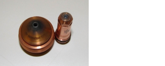

The above set of consumables was removed from a Hypertherm HyPerformance Plasma HPR260XD. This set cut more than 6,800 linear feet (or about 1.3 miles!) of ½ inch thick steel, and at the point this photo was taken, are only half consumed. This set easily has another mile left in it.
The frequency with which consumables parts need to be changed really depends on a lot of factors. The amperage at which you are cutting, the type and thickness of material you are cutting, the amount you cut per shift, and so on.
There are no hard rules. For this reason, it is very important that machine operators understand the function of the individual torch consumable parts. They need to know how to read wear patterns and determine when parts should be replaced or re-used.

One final note, never run consumables until they fail. The consumables shown below were used in a shop environment where the supervisor instructed machine operators to do just that. Unfortunately this method will lead to a catastrophic failure of the electrode which usually destroys parts—such as the shield and nozzle—that could have lasted two to 50 times longer than the electrode that failed. This type of usage can also cause torch damage, another expense added to the cost of cutting.
