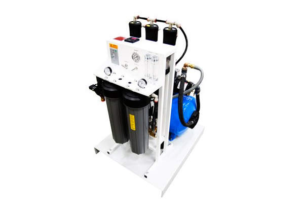

Water quality is critical factor in the operation of your waterjet cutting system. the Hypertherm Accustream® AS/RO Reverse Osmosis System extends component life and lowers operating costs by delivering purified, pressurized water directly to the pump.
Designed specifically for waterjet operation, the compact, free standing skid includes built-in prefiltration and provides up to 2,000 gallons of water per day to support pumps up to 75 HP. It offers superior performance, high water recovery rates and low energy consumption – allowing you to experience additional savings through lower maintenance and operation costs.
System information
Benefits
Maximizes uptime
- Extends component life by removing water-borne particles that act like abrasives and cause premature wear on everything the water touches
- Eliminates contamination from water that can damage your orifice and cause costly downtime
System features
- Includes all the necessary parts and connections to seamlessly connect your treated water to your waterjet pump
- Onboard boost pump and accumulator, together with the atmospheric tank, provide a readily available source of on-demand RO water directly to your system
- 63% recovery rate minimizes water consumption
- Digital Total Dissolved Solids (TDS) meter lets you see the quality of the water being produced; in-line blending valve allows you to instantly adjust the water to the optimum setting
