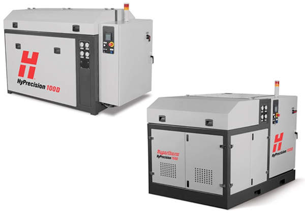

HyPrecision 100D/150D waterjet pumps (D series)
Hypertherm announced a new name for its HyPrecision™ and Echion™ waterjet pumps. It is rebranding these market leading intensifier-based pumps as DynaMAX™ to unify the naming of its intensifier pumps.
