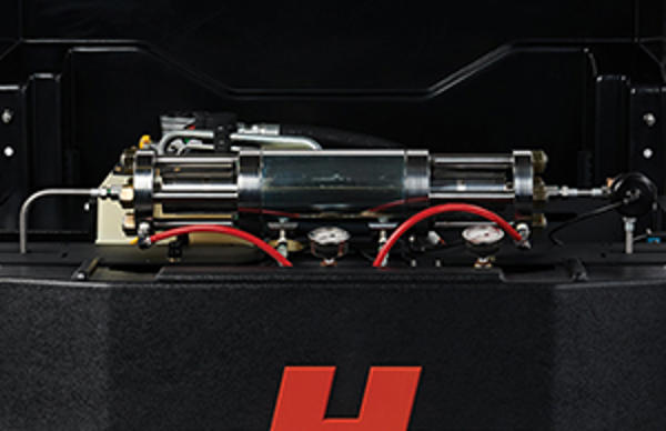

Inside Echion waterjet pump
Advanced Intensifier Technology simplifies system maintenance
Hypertherm Echion pumps incorporate cartridge seals, enabling rapid replacement of common consumables, leading to quicker return to service.
Echion AIT technology on pump
