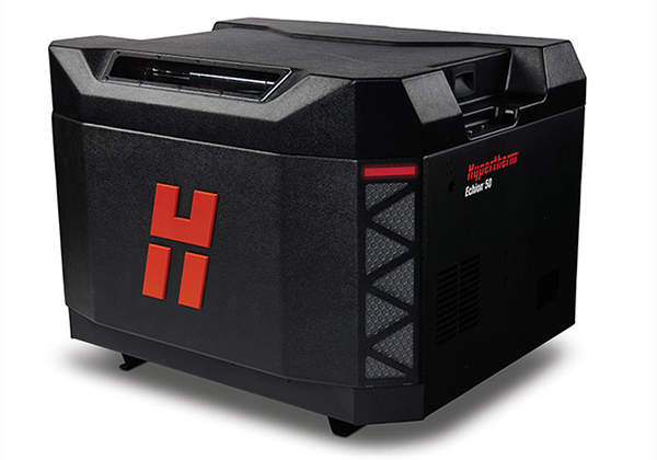

Echion 15/30/50 waterjet pumps
Hypertherm announced a new name for its HyPrecision™ and Echion™ waterjet pumps. It is rebranding these market leading intensifier-based pumps as DynaMAX™ to unify the naming of its intensifier pumps.
System information
Specifications
Pump model number | Echion 15 | Echion 30 | Echion 50 | ||||||
50 Hz | 60 Hz | 50 Hz | 60 Hz | 50 Hz | 60 Hz | ||||
GENERAL | |||||||||
Maximum output | 1.1 lpm (0.3 gpm) | 2.3 lpm (0.6 gpm) | 3.8 lpm (1.0 gpm) | ||||||
Maximum orifice | 0.18 mm (0.007″) | 0.28 mm (0.011″) | 0.35 mm (0.014″) | ||||||
Output pressure | Adjustable to 4,100 bar (60,000 psi) | ||||||||
Pressure control | Closed loop proportional pressure control – standard equipment | ||||||||
Bleed down valve | Air-actuated | ||||||||
PUMP POWER | |||||||||
Motor Power | 11.2 kW (15 HP) | 22.4 kW (30 HP) | 37.3 kW (50 HP) | ||||||
Voltage | 400 V | 208–230 V | 460 V | 400 V | 208–230 V | 460 V | 400 V | 208–230 V | 460 V |
Full load | 23 A | 45–41 A | 21 A | 44 A | 82–76 A | 38 A | 74 A | 136–124 A | 62 A |
Main breaker | 30 A | 60 A | 30 A | 60 A | 100 A | 60 A | 100 A | 200 A | 100 A |
Motor starter (options if more than 1 listed) |
Across-the-line | Wye-Delta Soft Start |
Across-the-line | Across-the-line Soft Start |
Wye-Delta | Wye-Delta Soft Start |
PHYSICAL | |||||||||
Width | 1,090 mm (43″) | ||||||||
Length | 1,350 mm (53″) | ||||||||
Height | 1,010 mm (40″) | ||||||||
Operating weight | 775 kg (1,700 lbs.) | 825 kg (1,850 lbs.) | 925 kg (2,050 lbs.) |
