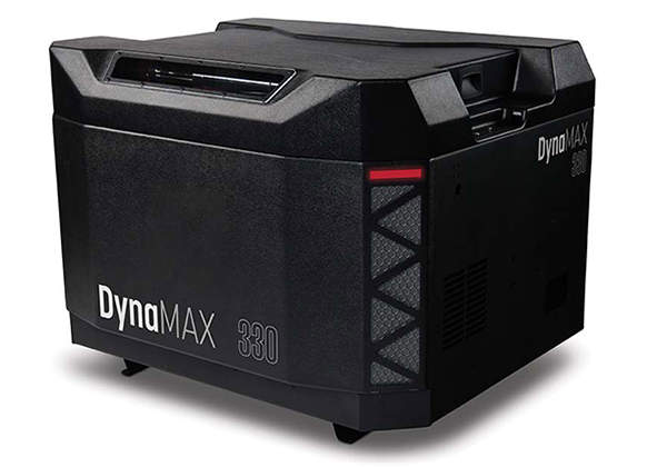

DynaMAX 3-series waterjet pumps
Available in three power levels, DynaMAX™ (Echion™) 15, 30, and 50 waterjet pumps deliver consistent cut quality at optimum cutting speeds and a design that simplifies service so maintenance is faster, easier, and less expensive. At the same time, DynaMAX pumps include features like fully integrated cooling for a smaller footprint that enables easy integration into small spaces.

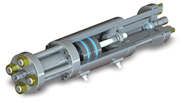

DynaMAX 3-series waterjet pumps include the next evolution of Hypertherm’s Advanced Intensifier Technology™ (AIT). This technology eliminates soft, static high-pressure seals and incorporates industry-leading cartridge seal design, enabling rapid replacement of common consumables.

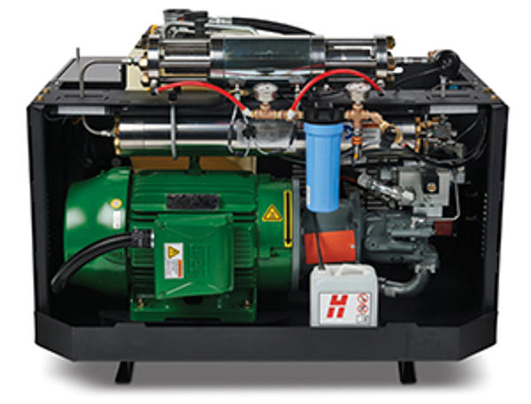

With 20% fewer parts than earlier generations, DynaMAX 3-series pumps include user-friendly features such as common service components located front and center, quickconnect fittings, and an easy access bleed‑down valve, to make maintenance faster, easier, and less expensive.
Interior of Echion pump

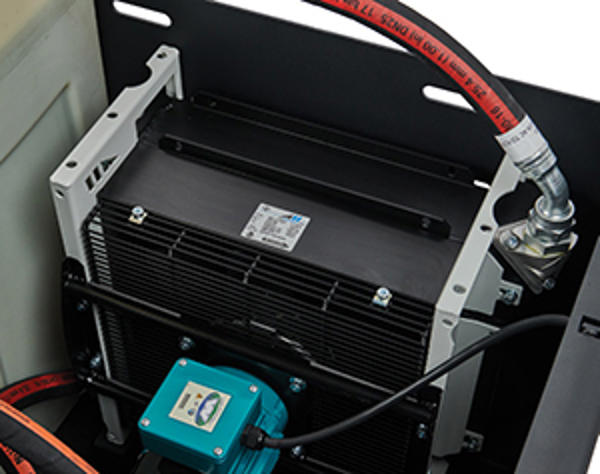

Smart industrial design, including fully integrated cooling, allows a reduced footprint, enabling integration into small, tight spaces.
Inside Echion waterjet pump
Advanced Intensifier Technology simplifies system maintenance
Hypertherm DynaMAX 3-series pumps incorporate cartridge seals, enabling rapid replacement of common consumables, leading to quicker return to service.
