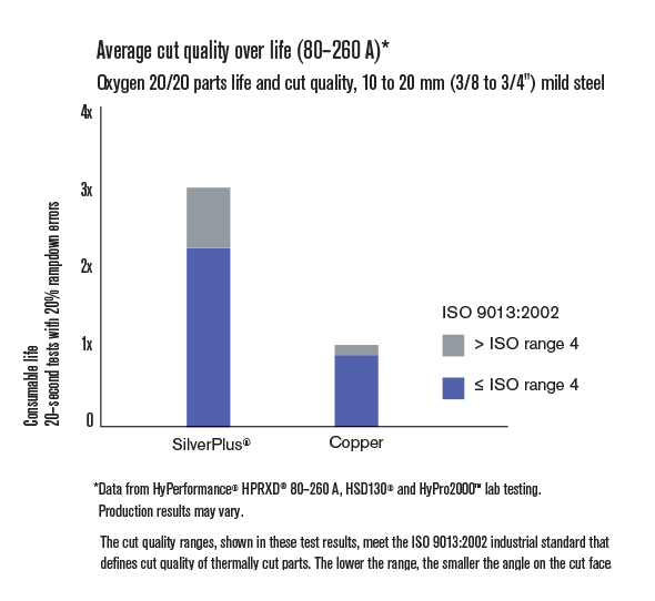

SilverPlus lasts over 2 times longer than standard electrodes
Our testing process
We used rigorous life tests to benchmark SilverPlus® electrodes against our standard electrodes. Our 20/20 test involves piercing metal and cutting for 20 seconds with 20% programmed ramp down errors. This means that 20% of the time, we purposely committed errors while cutting, such as running off the plate.
This test protocol is intended to simulate the actual cutting environment. We ran tests using Hypertherm's standard HPR oxygen cutting parameters. These procedures were repeated until the electrode no longer functioned.

Twice the life of all-copper electrodes
The unique design of SilverPlus electrodes minimizes debris build up on the inside wall of the nozzle, reducing damage to the nozzle orifice. As a result, SilverPlus technology doubles the life of both the electrode and the nozzle.
